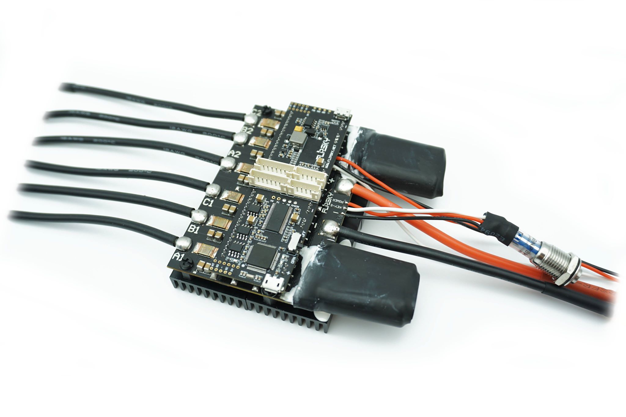

It's the dual esc6? Hello please, go to introduce you Thank you
Je comprends pas trop le dual FESC…
Y’a qu’un DRV et un MCU pour 2 moteurs… Ca sera pas compatible avec le FW VESC ça.
Good morning, Sir. I just checked with our technician, our dual esc is compatible with FW VESC.
So could you tell me that why would you think like that?

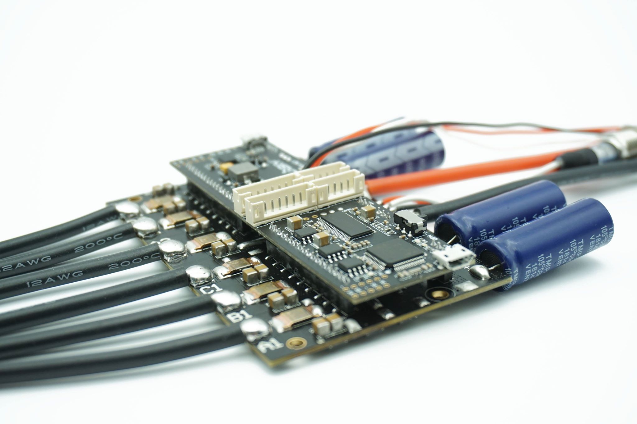

This is just a thought because on pictures, I can only see one MCU and one DRV for driving 2 motors.
I already digged into creating my own dual VESC using only one MCU (but still a DRV per motor, hence 2), but it’s way more complicated than only duplicate mcpwm.c files :lol:
So, could you confirm the HW setup on your board ? (if you’re willing to, you’re not obliged :wink: )

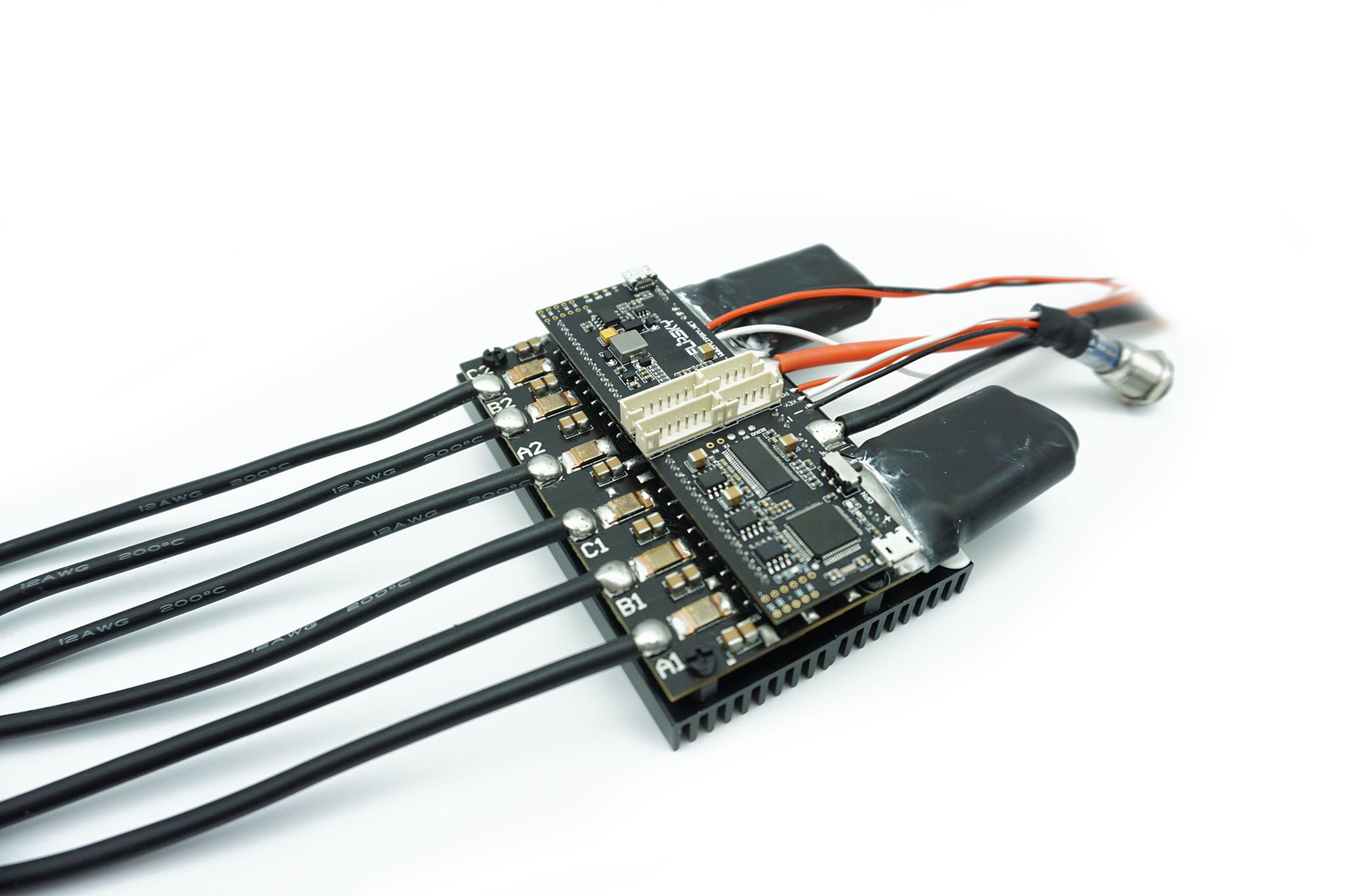

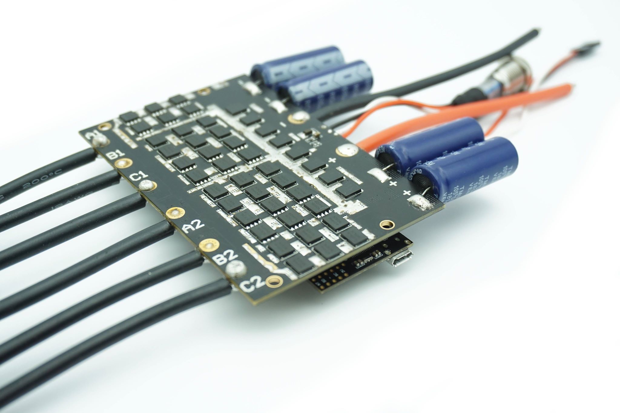

Hi, yes, I’ve been reading the thread since it’s created :lol:
And maybe it’s because the photo, but our dual ESC has two MCU and two DRV.
More photos shall be released tomorrow, I will post them here for your closer observation. :slight_smile:

Still, I’m not confident with this kind of PCB stack.
I mean, separate power and control stages is a good thing though, but I do remember VESC 5 design made by Vedder.
His idea was to stack, as you did, because he wanted to get rid of EMI on the control part.
However, he had a lot of trouble with the DRV because it was too far from the Mosfet gates, creating transcient voltage issues.
So he ended up with the VESC 6 layout that lowers this distance (This layout also "inspired"Enertion for the FOCBOX).
Did you perfom a bunch of heavy tests in FOC 12S ? No DRV errors ?
