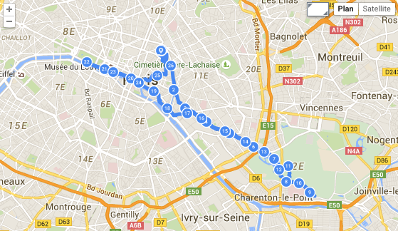

in an older session, I used my (« old ») board differently; just to go from A to B and come back to A. Didn’t focus on throttle management at all.
22km (13.7 miles) => 3200mAH used / APS ESCs
Check « this thread » on Endless Sphere, this is my old board (I didn’t do any thread on E-SK8.FR as I was starting a new build)
In fact, it also depends highly on how you ride, if you start from 0 or push then press the throttle. Now VESC are really awesome because the progressive start helps a lot
