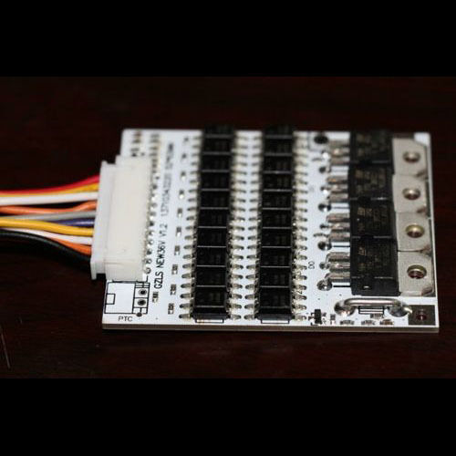

- Bms http://www.ebay.fr/itm/10s-36v-40A-Batt … Sw-7RVDDna 10.74€ port gratuit

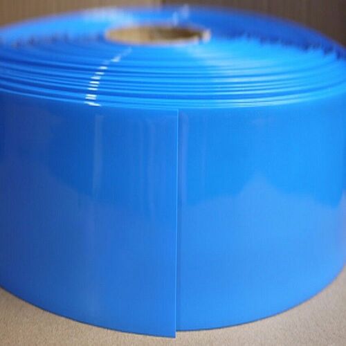

- gaine thermo ( Heat Shrinkable ) http://www.ebay.com/itm/Battery-Sleeve- … 1882238852 5.59$ port gratuit
